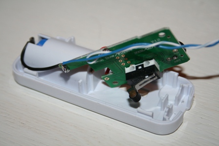

Thanks! Is it possible to take photo's from the inside of the device?
Alexander
Re: The Aeon Labs door/window sensor.
Uhm inprinciple that is how far you normally disassemble it for mounting or replacing the battery. I have not tried to take it apart any further, I will give it a shot on thursday.
just interested , why are you making wires to the wireless door / window sensor.
It will make no sence to me
No problem, but than it is better to direct you to: http://domoticaforum.eu/viewtopic.php?f=37&t=3303
