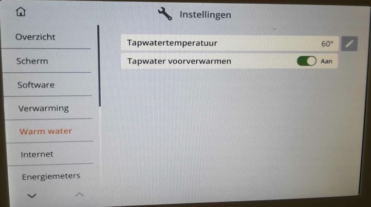

Something else:
Is there a way to Toggle the Switch 'tap water' by a Json command?
I would like to run some tests.
To switch it off in Domoticz when we're not at home
TheHogNL
Posts: 2125
Post by TheHogNL »
Try the url /happ_thermstat?action=setBoilerOnOff&state=off
I don't have opentherm so couldn't check with my Toon but I think this is the one.
Hypermobile
Posts: 76
Post by Hypermobile »
TheHogNL wrote:Try the url /happ_thermstat?action=setBoilerOnOff&state=off
{"result":"ok"}
but switch stay's 'on' :|
TheHogNL
Posts: 2125
Post by TheHogNL »
Ok then this is doing something else :lol:
I have seen on another Toon that it does send a boiler off or on command to opentherm. Maybe it is supposed to turn of the whole boiler itself or not, depening if the boiler accepts the command.
TheHogNL
Posts: 2125
Post by TheHogNL »
Found another URL which should be helpfull.. however I didn't manage to find the correct parameters yet.
The URL is /happ_thermstat?action=updateDhwValue
And should be appened with some unknown parameters. I tried &enabled=0 or &setpoint=40 already and some others. But no luck yet. The result is always OK but no messages been sent towards the boiler.
