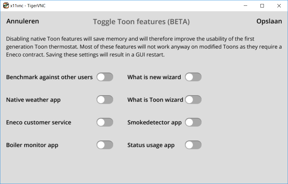

This evening I created a new menu in the TSC settings frame.
I will remove the BETA status of this shortly (tomorrow, maybe friday).
As the screenshot shows it allowes you to disable some native toon features which greatly improve the Toon1 memory usage and therefore the usability. It does this by changing the /qmf/qml/config/TenantSettings.json file.
Rudolf
Posts: 139
Re: TSC settings menu item
Post by Rudolf »
Very clever, looks neat!
From a UX perspective; I believe that in the screenshot all the apps are disabled/saving max. possible memory?
Sliding the button to the right means it can be used again?
TheHogNL
Posts: 2125
Post by TheHogNL »
Rudolf wrote: From a UX perspective; I believe that in the screenshot all the apps are disabled/saving max. possible memory?
Per default most of the apps are default enabled on a Toon (only 'what is new' is disabled per default). By sliding to the left it will change the config to disable those features and when saving (and a automatic QT-gui restart) this will indeed disabled them and free the memory. Enabling again (with a slide to the right) will allow you to use them again ofcourse. Most features are only for Toon subscription users so I guess that a lot of rooted Toon users will disable them to free the memory.
