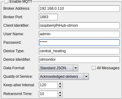

The problem i'm now facing is that when i enable mqtt the checkbox won't get enabled. to solve this i tried the web interface.
After enabling mqtt in the web interface i get the folowing error from otmonitor:
invalid command name "mqttmessage"

the mqtt settings in the settings file
mqtt {
  devicetype central_heating
  deviceid otmonitor
  retransmit 10
  format json2
  port 1883
  qos 1
  keepalive 120
  username admin
  password YWRtaW4=
  enable false
  messages false
  client raspberryPiHub-otmon
  broker 192.168.0.110
