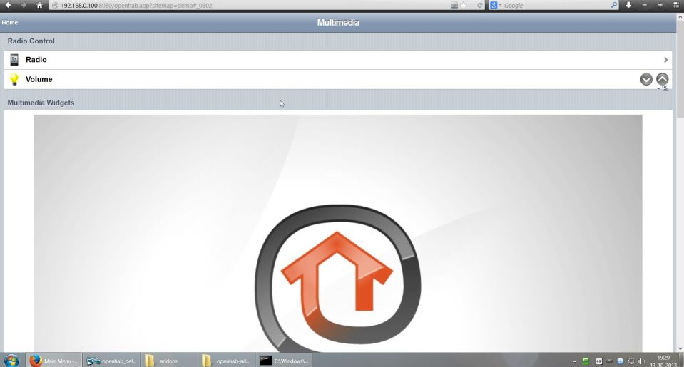

@ Harry..
Yhanks for your help.
And gues what, it is working..
It have work with my RFXcom, or couple of minutes
Nice very very nice, but no thing for me.
Why, i have to type everthing in scripts.[ and with my bad englisch ]
No simple config button or some thing like that in the software, like domoticz.
It looks great with all the options that the have.. realy nice
I hope more developors from Domoticz, take a look what uptunerties they have in openhub...
I think for sure i give my time to work with Domoticz. [ and hope for a lot of developing like Hub ]
Because developing is no thing for me.
Questions???... openhub runs on my windows 8 for test..
Only not working with the RFXcom, that one i used bij domoticz
I hope i can help you with something
