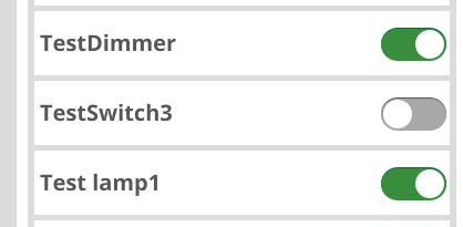

just tried this on the app, looking better indeed (not used your icons but the default Toon OnOffToggle element:

Toonz wrote:just tried this on the app, looking better indeed (not used your icons but the default Toon OnOffToggle element:
Thanks.
This looks better than the lightbulbs.
The attachment Untitled.png is no longer available

version 1.1.3 is available in the ToonStore.
Changelog:
- Lamp bulb icons on the main screen are replaced by an On/Off sliders.
- Dimmers are now (hopefully properly) supported including changing the dimlevel (let me know if you find weird behaviour)
