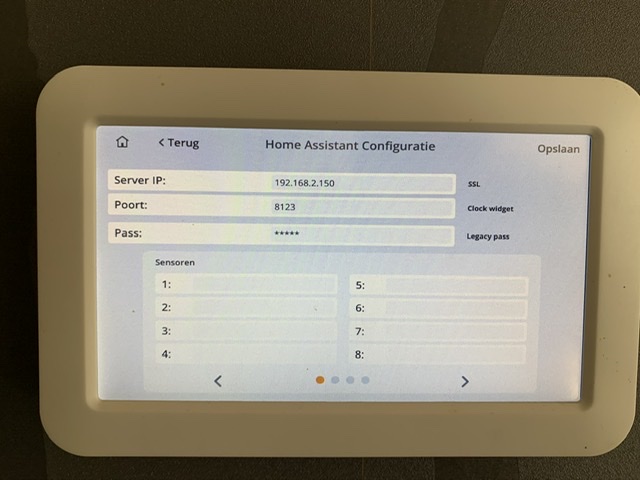

After the update, it looks like something isn’t okay, the switches on the settings screen are missing:
Somebody know how to fix it?

I haven't installed the app from the ToonStore yet, I will when I have the time. For now I would say try to check the drawables folder on your Toon and compare it with the files on GitHub:
github.com/Luc-S/Toon-HASS/tree/master/ ... /drawables
Should be the same files as you have on your Toon in folder
/HCBv2/qml/apps/homeassistant/drawables/
You can try to press the empty space anyway, maybe it still works. Else you can manually change your userSettings.json to how you would set the buttons as a workaround:
{"Clock":1,"Legacy":0,"Pass":"","Port":"443","SSL":"yes","Server":"xx.duckdns.org"}
This sets Clock widget to On, Legacy login to NO and SSL to YES.

Hmm I just installed the app from the ToonStore and for some reason it looks in the wrong directory for the switch images. Pretty strange because it only occurs for the switch images:
file://qmf/qml/apps/homeassistant/HomeassistantConfigurationScreen.qml:505:17: QML Image: Cannot open: qrc:/tsc/knob.png
The knob.png (and background images used for the knob) are located on /HCBv2/qml/apps/homeassistant/drawables/ so yeah, it cannot open qrc:/tsc/knob.png
[Edit]
The locations of images are modified for correct installation through the ToonStore I guess. I noticed all image locations are changed to 'qrc:/tsc/...' However I can't quite figure out yet why the switches are having problems with this.
[Edit 2]
As a workaround you can copy the 2 files below from github.com/Luc-S/Toon-HASS/tree/master/ ... eassistant into your "/HCBv2/qml/apps/homeassistant/" folder on your Toon and overwrite the existing.
- HomeassistantScreen.qml
- HomeassistantConfigurationScreen.qml
[Edit 3]
Toonz explained me that images used in apps must be included in the resource file since version 4.16. These switch images are new and therefor not available yet. He'll try to arrange this with TheHogNL.

When the app is packaged for installation through the ToonStore the DEVs change the absolute and relative paths to a different directory. This works fine unless you use new images and you don't let the DEVs know there are new images that need to be incorporated.
The files installed by the ToonStore have images paths like 'qrc:/tsc/image.png' and the files from GitHub still use the relative paths like './drawables/image.png'.
As a drastic workaround you can also uninstall the app from the ToonStore and copy the entire 'homeassistant' directory from GitHub into '/HCBv2/qml/apps/'. After a reboot the app should be available.
For me updating the 2 files worked. Do you have a 'drawables' folder with images on your Toon (in the homeassistant app folder)?
