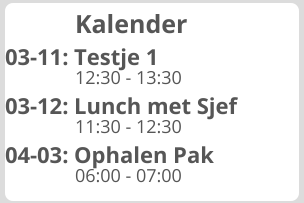

Posts: 1918
Re: google calendar
hi all,
small teaser with rubbish test data from my google calendar (via a cron job and wget)..... nothing ready to be released yet, but progressing :)
In dim state I am thinking of showing the first next/active appointment only.
Also need to redesign the UI on the tile (show dates as mm/dd etc etc etc)
Not sure when ready for a first release, I have a busy weekend coming up.....
