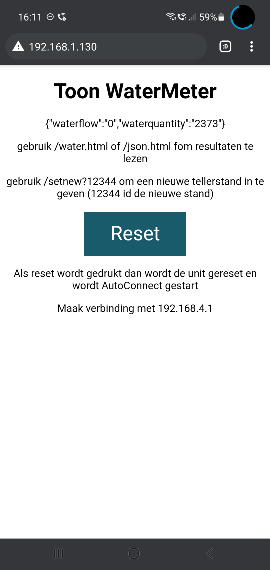

Toon WaterMeter
HTTP/1.1 200 OK Content-type:text/html Connection: close {"waterflow":0,"waterquantity":2300}

Reset the wemos and tried again,
Set network ip, host ip and subnet.
Went back to Toon and set Counter Values and that came back to the web portal so there is definitely a good connection between Toon and the wemos, just don't see any water usage on Toon.
