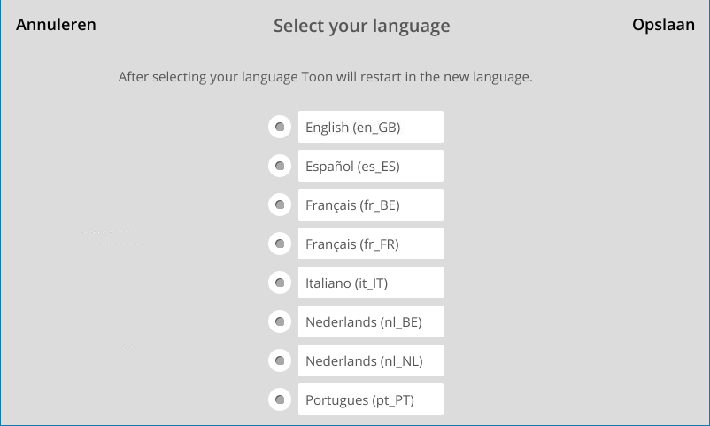

I just published my latest project on the Toonstore: Select Language (refresh your ToonStore data to make it visible)
This app will add a menu item which brings you to the language selection screen for Toon's user interface.
After selecting a language and press 'Opslaan' Toon will restart in a few seconds with the new language for all screens and apps.
All the current available languages on your Toon can be selected: English, Spanish, French (FR, BE), Dutch (NL, BE) and Italian.
The screenshot is also listing Portugues but that language is currently in translation and just there on my dev Toon.
If we can manage to add our own languages successfully I will publish a guide and material to translate for any volunteers.

The quickest is to edit file
/HCBv2/config/config_qt-gui.xml
And change to <locale>en_GB</locale>
after the edit save and do a full reboot (power cycle)
You can edit using winSCP, protocol SCP, name root password toon

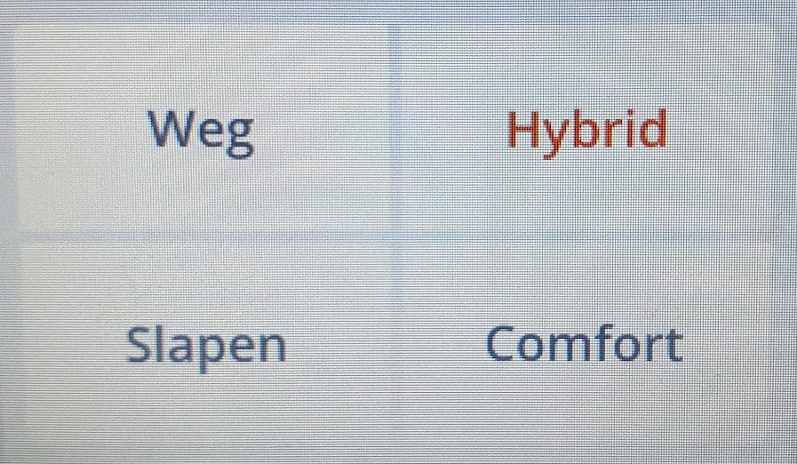

Is there also a way to edit the ButtonText:
- Away
- Sleep
- Home
- Comfort
why: i've created a Hybrid solution, with a Airco/Heater.
"Hybrid" instead of "Home" would be nice to have.

Dat zit ergens in de bronnen en komt weer uit de vertalingen:
qsTr('Comfort'), qsTr('Home'), qsTr('Sleep'), qsTr('Away'), qsTr('Vacation')
Aanpassen daarvan kan als volgt:
Ga naar /HCBv2/qml/apps/thermostat/lang en maak kopieen van de NL vertalingen (zowel de .ts als de .qm)
Pas de file lang_nl_NL.ts aan met de door jou gekozen vertalingen
Verwijder de file lang_nl_NL.qm maar behoud de kopie
Log in met putty en geef het volgende commando lrelease /HCBv2/qml/apps/thermostat/lang/lang_nl_NL.ts
De .ts file wordt gecompileerd naar .qm
Geef daarna in putty: killall qt-gui

Check :-) thx

Nu heb je engels en nederlands door elkaar. Je zou er Hybride van kunnen maken
Hypermobile
Posts: 76
Re: Toon App: Select Language Toon
Post by Hypermobile »
Fixed as well ;-o
