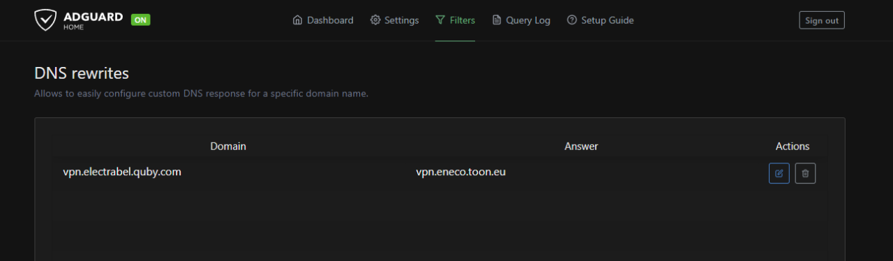

The only option to get the subscription features back is to root your Toon (see guides elsewhere).
However, you might run into troubles there because the VPN server of Viesgo is probably offline, looking at the multiple messages from spain that routing doesn't work.
Our firends in Belgium have the same issue but they could root and activate the Toon by rerouting the traffic from the Belgium (electrabel) server to the eneco server in NL which is still active. Not sure of the exact url of the Viesgo vpn server but you will see this during the rooting process
Google translate of the last post of his topic: https://toonforum.nl/d/822-activeren-bi ... op-boxx/19
¡Finalmente lo hice! Tráfico de Internet redirigido a vpn.eneco.toon.eu a través de adguard home. Y el botón salió ¡Gracias a todos por la ayuda y las sugerencias!
