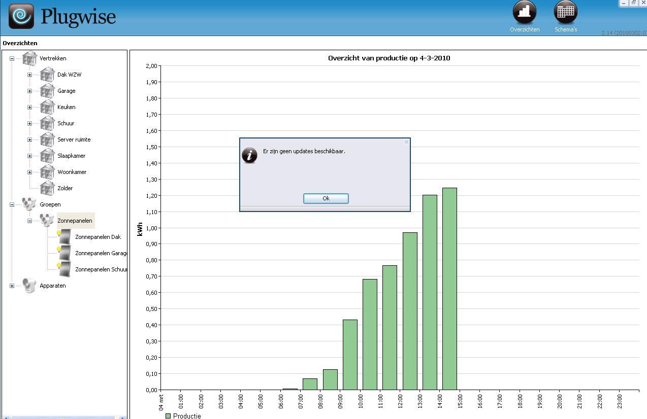

Re: New Plugwise Firmware 2.27, Release 20090908 available!
Hi Reinder,
I just updated the source and discovered at the top right corner:
2.14(20100302.0)
Circle firmware is 2009-09-08
Even after trying the 'update' button, result: 'no new updates available'
To be aware of, I'm a registered beta-tester.
Is something ongoing with firmware 2.27? Is it not public available anymore?
gr,
Jeroen
I don´t see the problem, your versions are exactly what Reinder advertised in his post.
Source version 2.14 and firmware version 2.27 dated 2009-09-08. That is what you have....?
Aha, that's make sense.
I thought the latest source version is 2.27 not 2.14 but this is the circle's firmware.....
Jeroen
Jeroen

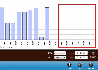

Just updated to the latest source and firmware.
The plugs do respond to switching correctly and all are online and updated.
The updates went fine, but now the usage data is no longer beeing logged in the statistics view.
I can see the current usage, but since the update the cummulative usage per hour is empty.
See the red zone in the screen shot.
First I thought it would just take some time to collect the data in the plugs and transmit it to the PC, but the Source has been running for 18 hours now (after the update) and still nothing.
Have also no logging of data after soft/firmware update, firstly.
Had a look to Plugwise web site, FAQ section, and find a way :
press shift + refresh button. A msg box will appear, press "OK". If data are still missing, restart Source.
It works for me, after having done it for each of my circle.
That fixed the missing data.
thx

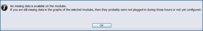

Indeed that fixed it. Thanks.
First I got a message that there was no missing data, but then after the restart of the source, the missing data was back.
I hope the data will be logged automatically from now.
