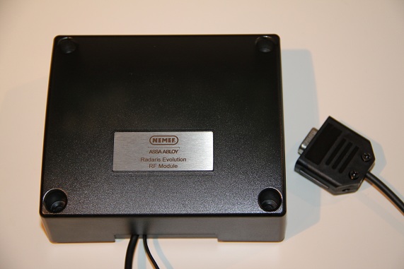

On the frontdoor of the Bwired House I have the Nemef Radaris Evolution door lock.
The Radaris Evolution is an electro-mechanical lock combined with a electronic door handle.
The lock can be controlled with RFID tags, Remote control or with the normal key. For the complete specifications of the Radaris Evolution and how it was installed in the Bwired house check my Dutch blog: http://www.bwired.nl/weblog.asp?id=375 and here domoticaforum.eu/viewtopic.php?f=23& ... amp;t=4775

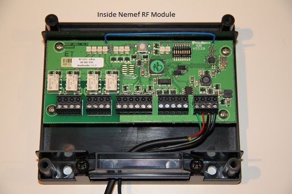

For Consumers and small companies Nemef has the Radaris Evolution RF Module available.

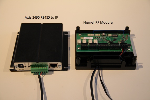

The Nemef RF Module has lots of possibilities available to connect, for the Bwired house I have integrated this device in my Home Control system via RS485 on the Axis 2490 or VSCOM IP to Serial Server.
The open Protocol for the RS485 interface is very easy to handle and allowing me to fully control the doorlock. Making the software driver was very easy to do, Nemef is way ahead on this compared to other companies giving total and easy secure access to there devices!
For example: I Can remotely lock and unlock the doorlock, See if the lock is on nightlock, and best of all authorize and see who is coming in based on the RFID tag. If access is granted by the lock or RF module I can trigger all kind of events like Disabling the alarm, open or close the electrical curtain behind the front door and turning on the light in the hallway at night. The RF Module has a lot of options and standard in and outputs available, for the complete documentation and the open protocol download the manual
The Nemef RF module can handle op to 4 Radaris Evolution electro-mechanical locks making it ideal for houses and small businesses.

Nemef radaris RF Module
Nemef RF Module on IP server
Nemef RF Module In and Outputs
