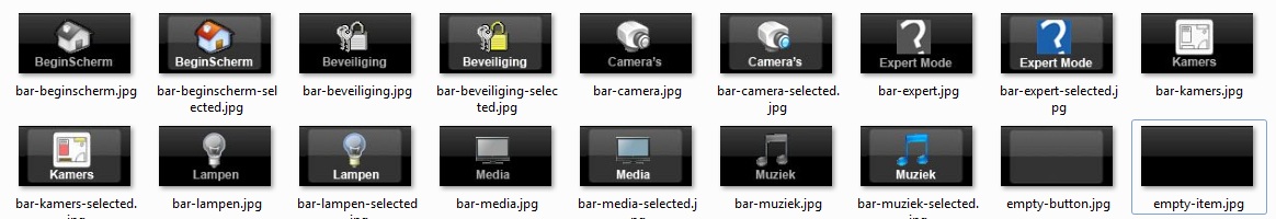

nice work, i think i might use yours too. I once started with something and although it looked nice at the beginning it still didn't grasp me.. but now that i had a ipad2 for my birthday from my gf, i really need to make some effort into it
Anyway, not stealing your thread just showing and uploading the icons i had if someone finds them usefull.
