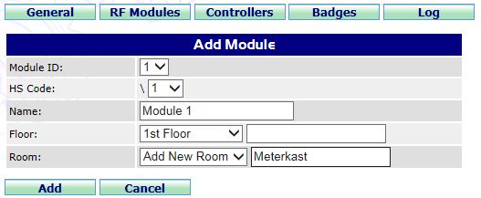

Re: Nemef Radaris Evolution Plugin
I have connected the RF interface.
It is a USB interface and seen by the computer as a com port.
It is com port 8
At "general" I have selected serial and com port 8 and saved it
When I go to "RF modules" and select "ADD" nothing happens and no module is added.
It says all modules are configured, but there is no module visible.
Please advice.
It is com port 8
Please advice.
Peter,
To speed things up a bit (13 hours have passed between you posting & me reading) it's better to mail me @ home.
The Plugin has only been tested very briefly with serial so a lot of things can still go wrong.
After adding the Module the next thing you'll have to do is add a controller as well ("the door lock", cause a single Module can control up to 4 Controllers IIRC).
Only after that the Plugin will start "collecting" badge Id's which are being used, so that you can add them, name them and so forth.
For now:
When I click "Add" I get his: After a 2nd "Add" click I get his: Is this the same as what you're seeing?
Awaiting your response (including a debug log @ highest level if not...) at my home email address; just pick an obvious one
For now:
