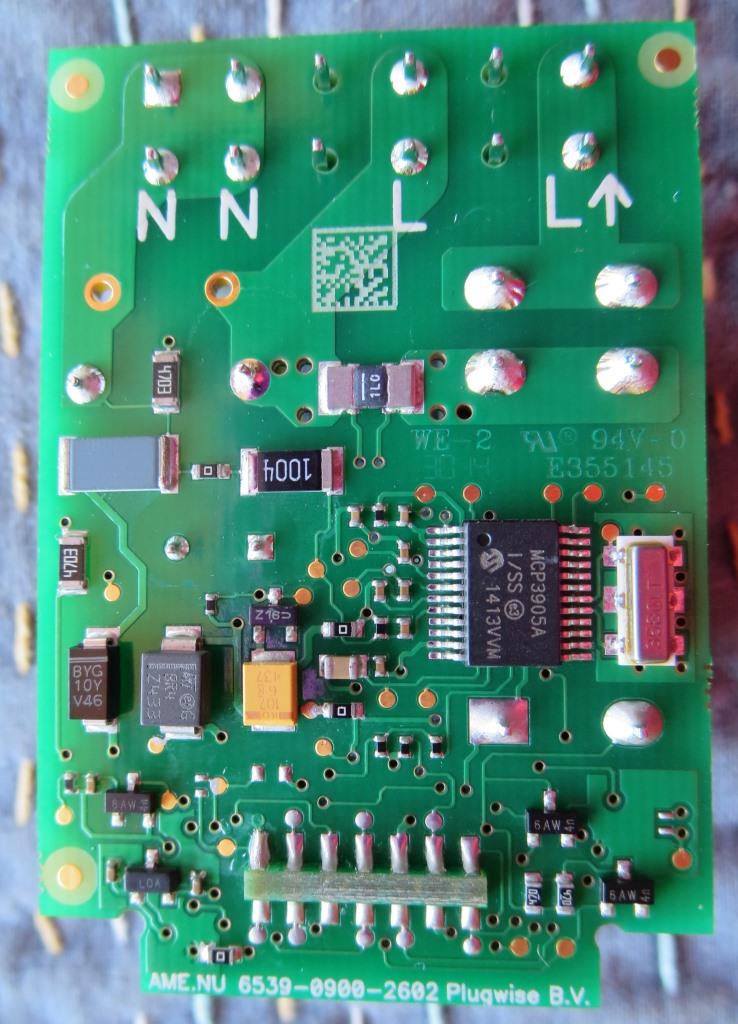

Plugwise Stealth hardware
Open the box (not that I would do that, of course; instead I employed my X-Ray camera), and you would find a small PCB with a smaller daughterboard. This could be a 14-pin standard PICtail interface design in which case RC0 is expected to be the default output to timer1 clock through an opto-isolator (speculation on my part – it’s a custom daughterboard).
Daughterboard
The main chip (Ember EM250) is a now-outdated ZigBee SOC. It has a 12MHz 16-bit processor core, 128k Flash, 5k RAM and a 128 AES engine in addition to the transceiver. Immediately adjacent is a 4 Meg serial firmware flash memory.
Main Board
The metering function is all on-chip, contained within a MCP3905A metering IC. This little bunny will measures ingle-phase active (real) power at 0.1% error and employs the IEC standard with very low shunt resistance (<200 microOhms) providing a proportional frequency output. The shunt appears to be a 1 millliOhm (0.001 Ohm) PMR25 resistor (marked 1L0 between live in and live out). These are rated as 1W.
The mains relay is a high-dielectric (5kV) 5V miniature relay with single pole single throw 16A connectors.
Thoughts
So – the relay contacts are obviously a vulnerable area, but if they were replaced or bridged, what is the maximum current that can a) be put through the shunt and b) be measured and transmitted safely? The shunt will be dissipating 1W at 37A AC RMS, so putting more than 30A through is obviously getting to be a concern (about 0.03V drop). Spec says 16A; I wonder if there is headroom in the frequency and/or parameter transfer for a higher current if the shunt will take it.
The 3905 reference design is specified for 10A with a 40A limit, using a shunt resistor of 250 microOhms (one quarter of the Plugwise implementation). If the current design doesn’t have a headroom for 32A measurement, one possibility (albeit a workaround) is a new shunt, an upgraded relay, a new device type in firmware, and use of a multiplier in the calculation software. I would be interested if anyone has got into the guts, as it were.

Yes, I can find other means of controlling the higher amperage circuits, but I wish to be able to integrate these higher demand circuits into the SMA home Manager displays, and load-shed when operating entirely on battery (later) or when solar energy drops (now). A Pool Pump is exactly the sort of load that one would want to shed when the sun goes in (even if I don't have one
). A Spa has an always-on recirculation pump, but you might want to reschedule the cleaning cycle when the main pumps kick in. Air Conditioner loads - you might want to control an AC using infrared, but measure the load current. Refrigeration loads (we have coldrooms) are also outside the 16A limits.
There are work-arounds for controlling a high-amperage circuit set - the obvious is to use Plugwise to control a heavy-duty contactor without current measurement, and I may end up doing this - no messing with the internals. An expensive option is to employ a meter and a Smile, or another SMA meter, but there are potential problems with these approaches beyond the high costs. A more intrusive approach is to relocate the shunt and relay elsewhere, if the measurement protocol allows higher recorded current.
The shame is that the plugwise contains a metering chip which can happily handle any amount of current registration with the appropriate shunt. The unit as manufactured can probably handle higher than 16A, although the relay contacts are an obvious limiting factor. Tweaking the shunt alone should make it handle 40A peaks. Sure - I would re-evaluate the Stealth spring clips in such a case and the relay would have to be replaced, but a repackaging into a DIN Rail unit with standard screw terminals would solve a multitude of problems and open up some new options, even if the contactor is made external.
