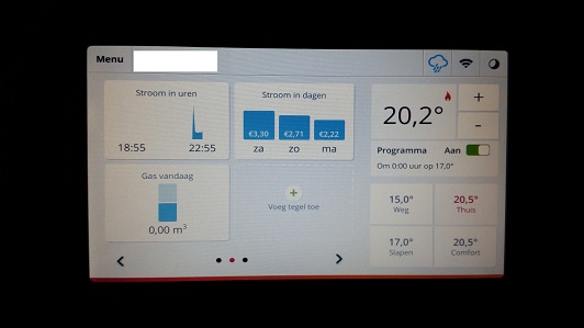

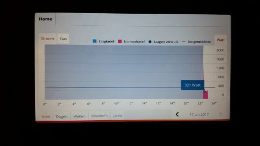

Apologies for the picture quality.
On the detail screen you can scroll through the years, months, weeks etc

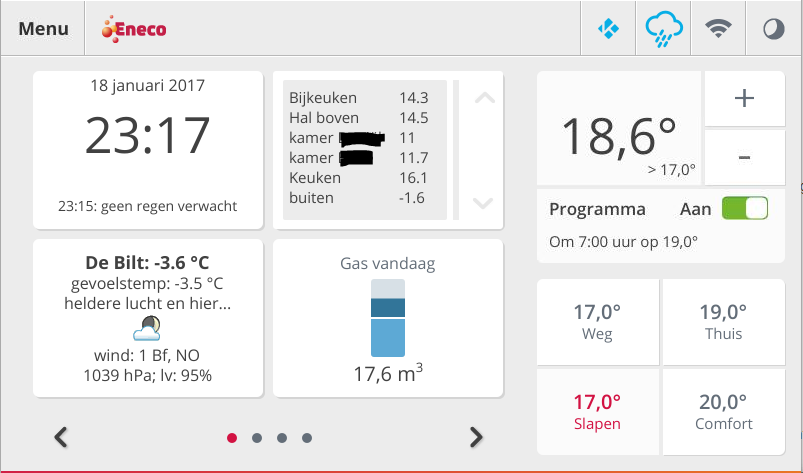

All, Inspired by, and based on, the applications I saw here and the excellent buienradar tile from Toonz, I decided to dive a bit deeper into qml and java and build my first application. I have used the clock tile and added information regarding the rain expectations from Buienradar. It shows the upcoming three instances with rain, if any rain is expected in the coming hours. This way, you don't need an extra tile for this information.
Regenkans tile view
Regenkans tile view
Regenkans tile.PNG (67 KiB) Viewed 12233 times
Clicking the tile, activates the screen with the full details regarding rain expectation.

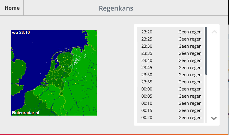

Regenkans screen view
Regenkans screen.PNG (80.93 KiB) Viewed 12233 times
Attached you can find the files. Apart from registering the tile as 'regenkans' in the Globals.qml file, you will also need to change the lattitude and longitude values in the regenkansApp.qml file. Note: Buienradar only accepts 2 decimals for the rain forecast data.

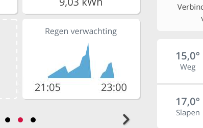

Posts: 1918
Just a mockup example (with my 24 points testdata instead of the 24 values from buienradar (no rain expected right now)).
Needs a proper Y axis with max value in mm/u and it would be nice if we can add rasterlines for more precise reading. Or simply click on the tile to go to the Buienradar page with your detailed table. This tile is certainly not the final answer but it might spark further ideas.

screenshot tile (based on my own mockup rain forecast file):
If there is no rain predicted in the next 2 hours the tile will only show "Geen regen verwacht".
