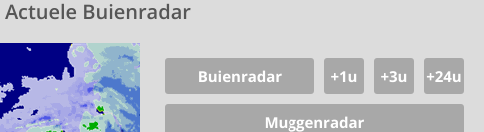

small update to the Buienradar app now available on ToonStore.
Changelog version 8.3.2:
- added additonal options on the big buienradar screen to also select
radarimages for the next hour, the next 3 hours and the next 24 hours.
Kind regardz,

Is it also possible to add Motregenradar ?
It should also be nice if touching Regenverwachting that the "Actuale buienrader" shows up instead of the settings.
Same when touching the little buienradar picture at "Actueel weer plus verwachting".
Posts: 1918
Re: Toon app: Buienradar
glsf91 wrote:Is it also possible to add Motregenradar ?
Probably yes, will have a look
EDIT 22:40 : done, will be in 8.3.3
glsf91 wrote:It should also be nice if touching Regenverwachting that the "Actuale buienrader" shows up instead of the settings.
Guess not, how to configure the exact location for the regenverwachting in that case?
glsf91 wrote:Same when touching the little buienradar picture at "Actueel weer plus verwachting".
Good idea !!

glsf91
Posts: 184
Post by glsf91 »
Thanks!
Maybe add it as an extra button at the upper line at the screen "Actuele buienradar", like it is like Weerstation on "Actueel weer plus weersverwachting" ?
If somebody else touches Regenverwachting they get a screen they don't understand and chances of changing it. So to hide it a little bit would be nice. and then you can show Actuele buienradar :D .
Just my opinion.
