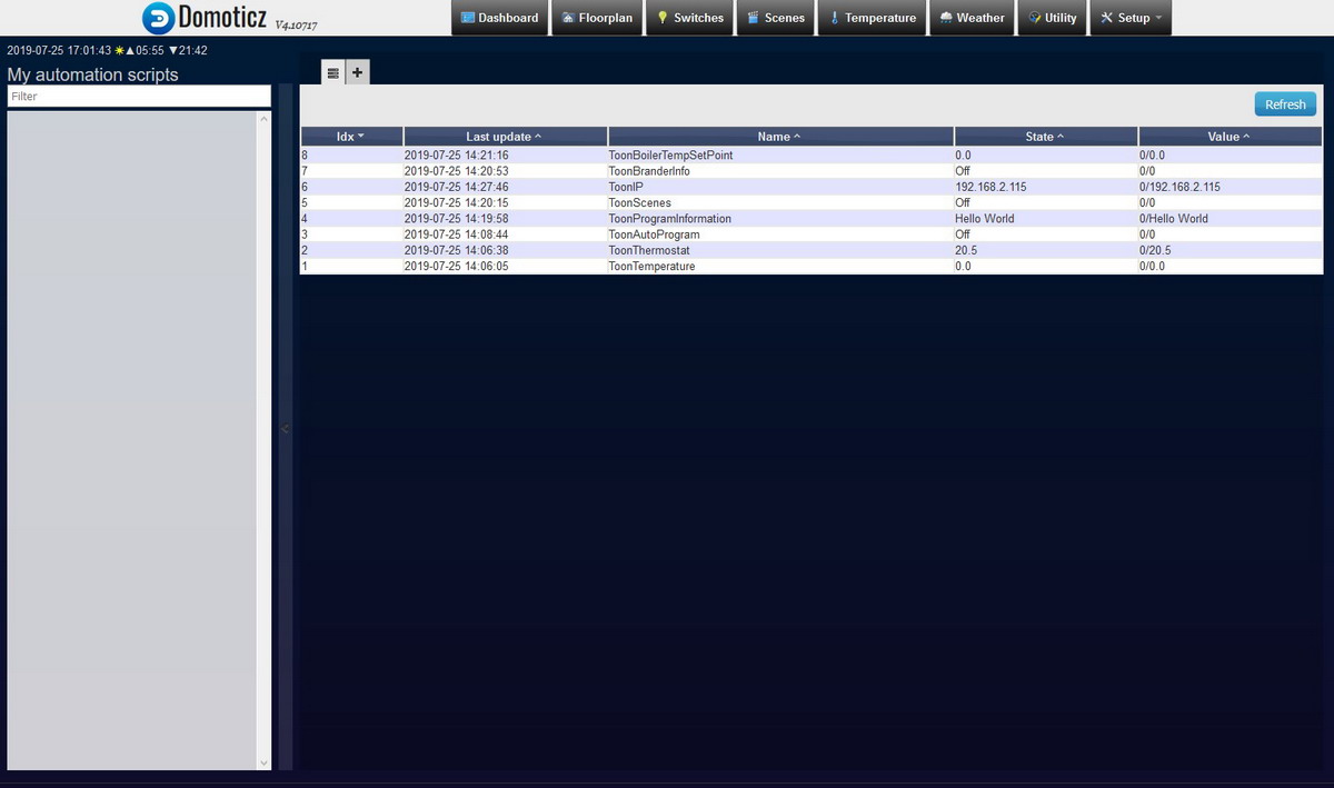

witteherder
Posts: 25
Joined: Thu Jan 10, 2019 2:28 pm
Re: Controlling Toon via Domoticz
Post by witteherder »
At step 7 I have put by Eventsystem everything on ON
Then I went to Setup More options then to Eventst to add scipts.
Then I see this like in my attachement.
1. Where can i put/add extra script Toon_script.txt
2. I also see in this topic that its not working by everybody who has a Toon2: What do i have to change in this script:
