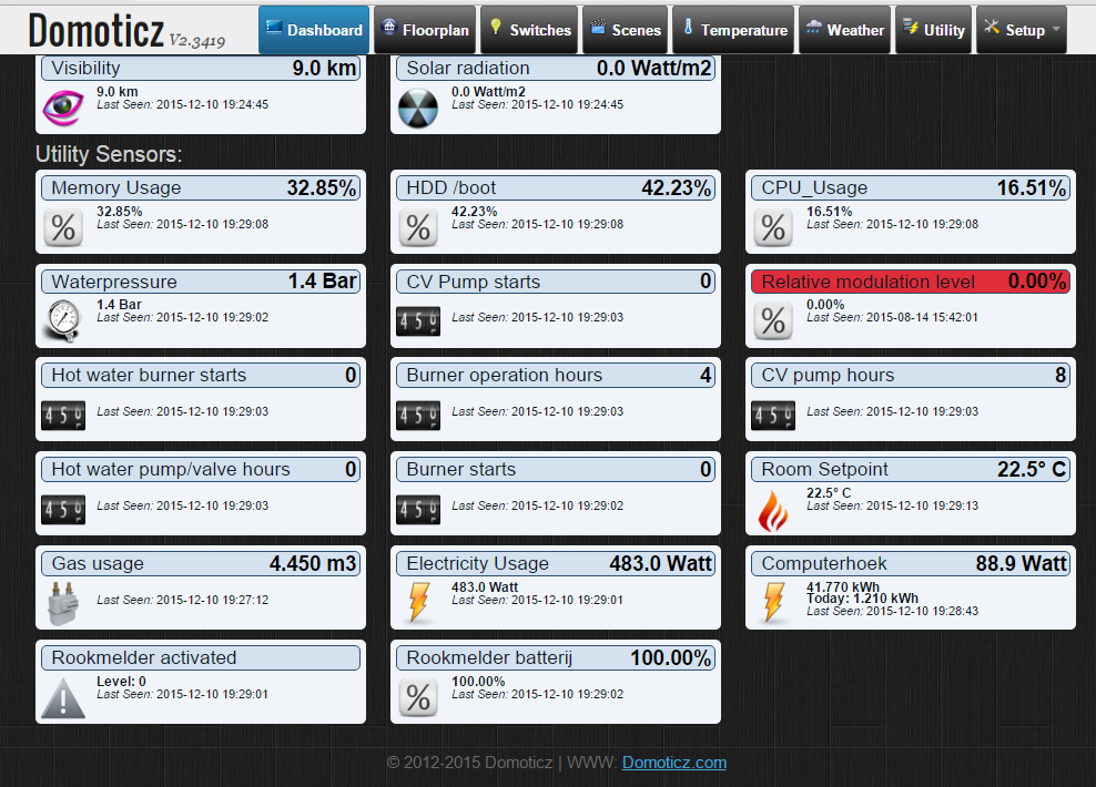

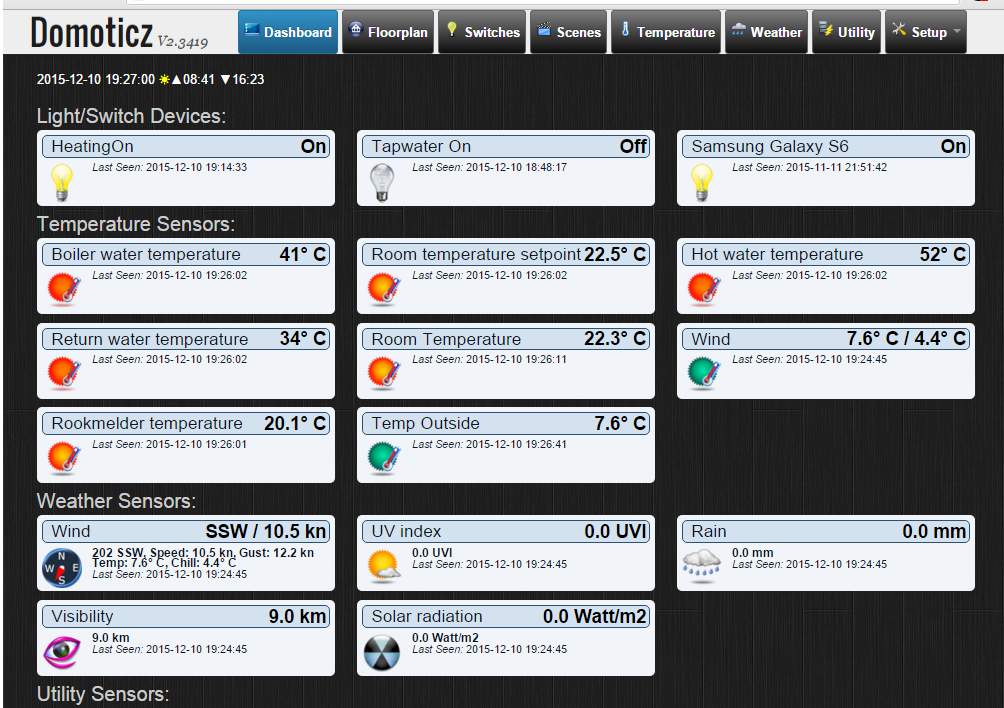

Here you can see some screenshots with OT data from Toon. I know there's a json call to set the programs and thermostat just have to find it again.
