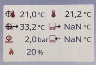

After updating firmware to 5.39.7 some values show NAN
Is this a known issue ? See attached screenshot

Doerakker wrote:After updating firmware to 5.39.7 some values show NAN
Yes. For unknown reason the Toon developers removed boiler water in and out from the information available for us. Maybe to save disk space because they don't use those values themselves in a regular toon.
