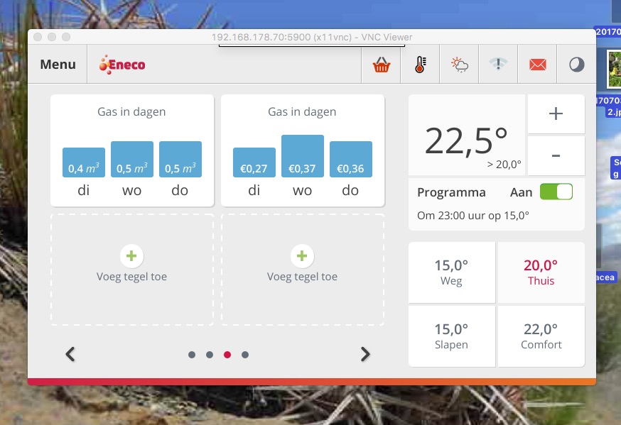

DomoticzBoard does not have a .ipk on board. Is it sufficient to transfer only the map to /HCBv2/qml/apps and then put a row in Globals?

walberg wrote:DomoticzBoard does not have a .ipk on board. Is it sufficient to transfer only the map to /HCBv2/qml/apps and then put a row in Globals?
Yes
Yes
Globals.qml
// Base set of apps that is available on all displays
var appsToLoad = [
"homescreen",
"systray",
"thermostat",
"clock",
"buienradar",
"temperaturelogger",
"toonstore",
"systemSettings",
"thermostatSettings",
"internetSettings",
"DomoticzBoard",
"eMetersSettings",
"settings",
"graph"]
I put "DomoticzBoard", on the programs to load, too bad when adding a tile i could not find Domoticzboard and Toon is duplicating another existing Tile so now i have 2 tiles with Gas prices
Schermafbeelding 2017-09-22 om 15.16.09.jpg (99.47 KiB) Viewed 22501 times

Post by walberg »
Tried to install Domoticzboard but nothing is done, how does this program knows on which ip adres Domoticz is? There is also not a source to make a tile for Domoticzboard.

Post by DennisD »
Then you haven't installed it correctly, did you reboot after you edited it? Did you edited the file DomoticzBoardApp.qml within the domoticzboard folder , because there you have to set the ip of you domoticz, and edit the switches and scenes you want to have. DomoticzBoard doesn't has a tile but it will appear in the top right corner
