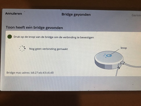

lsiepel
Posts: 14
Joined: Tue Oct 31, 2017 8:49 pm
Re: Manual: Domoticz devices to Toon (HA-Bridge solution)
Post by lsiepel »
I have similair problem. I try to connect the Toon with openhab Hue emulator, but it hangs on connecting. The openhab hue emulator has pairing set to enabled.
Any thoughts?

lsiepel
Posts: 14
Post by lsiepel »
Got it fixed, openhab was running at port 8080 and the toon config file had port 80 configured.

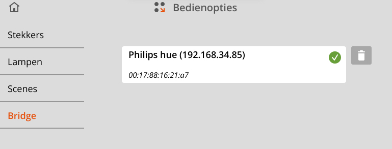

michel30
Posts: 288
Post by michel30 »
Hello,
I edit this file
 /mnt/data/qmf/config/config_hdrv_hue.xml
and reboot the TOON.
When I go bedienopties and bridge I see a philips hua connected but not my IP etc.
When I click on the trash bin it ask me do you want to delete this, but nothing happens.
my config file in config_hdrv_hue.xml looks like this:
<Config packageRevision="167">
   <sysConfig>
      <locale>nl_NL</locale>
      <timezone>Europe/Amsterdam</timezone>
      <currency>EUR</currency>
   </sysConfig>
   <hue_bridge>
      <package>hdrv_hue</package>
      <uuid>daa9c3e9-549d-4c7f-a9a9-fda64b17d0e6</uuid>
      <type>hue_bridge</type>
      <name>Philips hue (192.168.2.19)</name>
      <internalAddress>b827ebxxxxxx</internalAddress>
      <visibility>1</visibility>
      <profile>ConnectedState</profile>
      <ipAddr>192.168.2.19</ipAddr>
      <modelName>Philips hue bridge 2015</modelName>
      <serialNumber>xxxxxxxxxxxx</serialNumber>
      <cfgName>Philips hue</cfgName>
      <swversion>1705121051</swversion>
      <apiVersion>1.19.0</apiVersion>
      <port>8400</port>
      <modelNumber>0</modelNumber>
      <linkState>3</linkState>
   </hue_bridge>
</Config>
the Philips hue bridge is running on my Raspberry PI on port 8400 and I can connect with my browser in the HA Bridge http://IP_RASPBERRY:8400/ and switch on the lights etc.
How do I get this in my TOON ?

michel30
Posts: 288
Post by michel30 »
Hello,
I have still an problem with this:
I change the settings here mnt/data/qmf/config/config_happ_scsync.xml to have all the icons on my Toon, that works.
I have only an problem that there is all ready connected in my toon, the same is for smoke detectors. Last summer I reset everything to factory default.
I cannot ontkoppel this one is also the IP range is not my, the same thing is for the smoke detectors it says press 3 times the smoke detector.
philips hue raar.jpg (37.55 KiB) Viewed 20274 times
michel30
Posts: 288
Post by michel30 »
Hello all,
Does somebody know how delete above topic?
I check the log files in /mnt/data/qmf/log but there is nothing that shows me why I can not delete the hue bridge.
This is not something that I add in I don't know where it is coming from.

michel30
Posts: 288
Post by michel30 »
@TerrorSource :oops: that is it ... :roll: super now it is connected.
