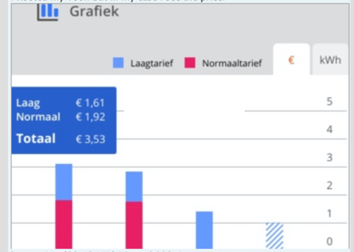

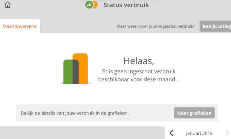

I enabled all the apps on my Toon but I have a small issue that I don't have the old view history.
This is what I have
This is what I have
When I press the button go to grafieken nothing happens.
Before I did not had this menu, I only enabled all apps to have the hue lights, I want to have my old grafieken back:
get back this menu
get back this menu
getback this menu.jpg (80.21 KiB) Viewed 7813 times
I have software version 4.10.6 and I edit this file config_happ_scsync.xml to get all icons to set endate on -1
Posts: 1918
Re: How to enable Apps/Tiles without a subscription
Have you tried this: viewtopic.php?f=87&t=11234&p=81575&hilit=graph#p81575
'Status verbruik' only works if you have a subscription and have the Eneco VPN open.
