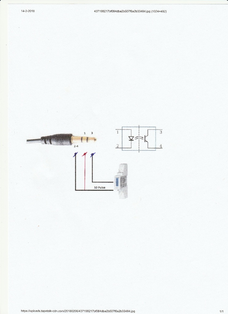

So if I understand it correctly:
I have this kWh meter (S0 only) between my solar panels: I can cut this cable and connect it to my kWh meter: and the other end to this: Change "SolarDisplay" and "SolarActivated" and set the pulse to 2000 and I'm done..?
That would be awesome
Re: ZonOpToon alternative
Correct. You could also use an old stereo headphones kabel (3.5mm jack plug) cut on one end.
Be sure to use the wiring as shown in a few threads earlier (domoticaforum.eu/viewtopic.php?f=87& ... 969#p85244)
Owh, and ofcourse you need to have a P1 meter for mainpower and have the Toon meter connected using the P1 interface. Because the 3.5mm connector is now used for the solar power. Needless to say maybe

Hello Toonists,
After some experimenting with the energie adaptor, there is a little update needed.
This has to do with the reading of the S0 puls, in piticilar when you connect i as the schema domoticaforum.eu/viewtopic.php?f=87& ... 969#p85244
this the correct way to connect, only it is not complete! if you only connect these two wires and you plug in the Measuring adaptor there will be no pulse be read in,
because the input is not activated on the measuring adapter, or you has to first activate the input with a optical sensor, then remove it for the S0 puls then it works en wil the pulses been read in,
only thing if there is a power drop it would not be started up, ore you have to power up the measuring adaptor again with the optical sensor, ore you have to connect the optical sensor paralel en leaf it.
easiest is to short the contact 1 by contact 2 and 4, there has to be a current flow tho make the measerings adaptor input to being activated after a power drop or shut-of.
Normally between 1 and 2 there is a current flow through the led, i have directly shorten this and this seems to be no problem and activated the input after powering up the measuring adapter.
see the little modified schema for what i mean.
- Modified, for cold start
- image-2018-02-14.jpg (149.5 KiB) Viewed 21153 times

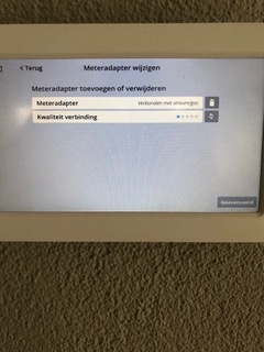

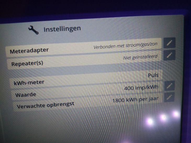

I have received connected my KWH meter KWH1073PRO and connected the S0 to the TOON adapter (see picture) which is also connected the the smart meter via P1
I edited the config_happ_scsync.xml and enabled "SolarDisplay" and "SolarActivated". I can add ToonZon tegels
I rebooted the TOON and the adapter.
But still no readings on the Toon.
I assumed I had to enable TonZoon in the configuration and configure the meteradapter settings like pulse but I don't see such panel in the setup (see picture)
Any help is welcome.
Thanks,
Thanks,
Hallo Rien and Toonist,RdP wrote:Ok
If reed yours problem, as i try to read the picture you took from the settings of your Toon, i think i can read Verbonden met Stroom/gas so your settings are not complete see my picture of the settings!
I think you better remove you meter adaptor by pressing remove and press the little black button on de side of yours measuring adaptor, (let the p1 and the sun S0 input sits where they are) if you get the check when it says removed you can teach it again by press the teach-in button in settings again and follow the instructions and this will be press several times the little black button on the measuring adaptor (there will be a question by teach it in to do this in close ranch = about 2 meters this (if possible)
then you will get again a check .
Toon wil say that the sensors are being configured.
Suc6.
Globegrabber
