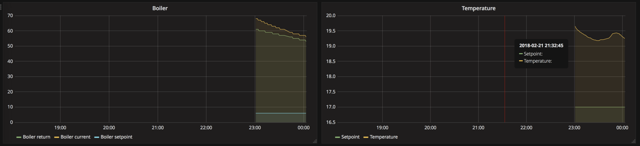

As far as proof of concept goes, see attachment
- GrafanaPoC.png (55.54 KiB) Viewed 14078 times

It makes a list of all the dat files in the rra directory, puts the 30days ones in an array, and iterates over the array every minute, getting the latest value, and pushing it out over mqtt.
As people have stated earlier on in this post, the NodeJS/NPM/MQTT combination does seem quite 'heavy'. Also, not all data is written to the database, so the boiler modulation for example will still have to be retrieved in a different manner. Since the database data is not real time, I'm starting to wonder what the added value of mqtt is here, especially because of the effort it takes to get it on the device, and the resources it needs.
So I expanded my iotserver to also get the data via http. The only drawback is that you cannot get all the metrics in one http call. So to get them all (assuming they're all interesting), it takes over 30 http calls every minute, which seems inefficient also. How are you guys doing this?
