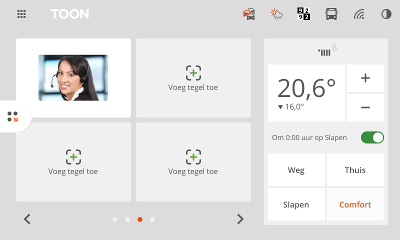

I just tested it again to make sure it works. This is the code I used (in directory /HCBv2/qml/apps/xxx):
XxxApp.qml:
import QtQuick 2.1
import qb.base 1.0
App {
    property url tileUrl: "XxxTile.qml"
    function init() {
        const args = {
            thumbCategory: "general",
            thumbLabel: "Xxx",
            thumbIcon: "qrc:/images/unknown.svg",
            thumbIconVAlignment: "center",
            thumbWeight: 30
        registry.registerWidget("tile", tileUrl, this, null, args);
XxxTile.qml:
import QtQuick 2.1
import qb.components 1.0
Tile {
    Image {
        anchors.centerIn: parent
        source: "http://localhost/images/xxx/xxx_large.jpg"
Xxx tile screen shot
What happens if you try to access the file from the command line?:
cd /tmp
wget http://localhost/images/xxx/xxx_large.jpg
I'm doing this on a toon 1. I expect it works on toon 2 as well, but I don't have one to test that assumption.
