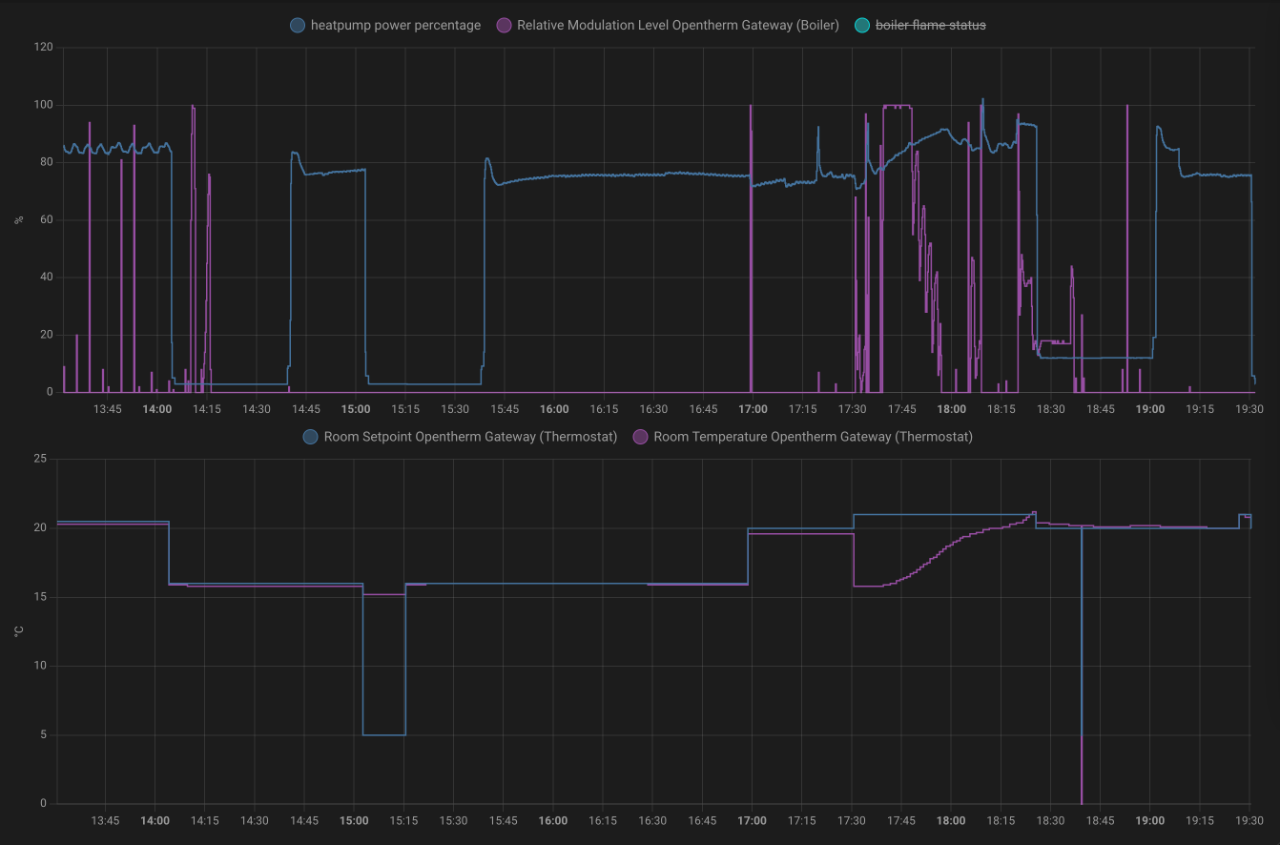

After having both OTGW's running for a day and taking a look at both logs, it seems like the heat pump is passing on all the messages unmodified. I couldn't find anything that is changed from to logs or from the graphs created by otmonitor.
With the information from this thread I can now see a clear pattern, the heat pump does react on the room setpoint and room temp:

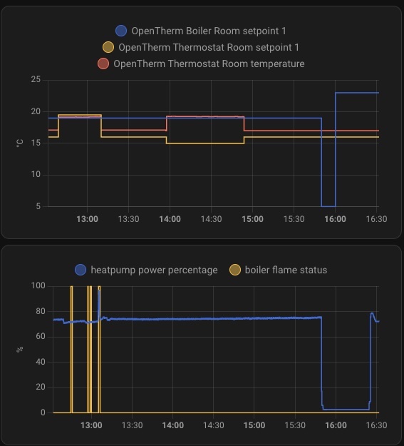

hvxl wrote: Tue Mar 14, 2023 11:54 pm Firmware 6.5 has a new BS command, that can be used to manipulate the room setpoint sent to the boiler.
I noticed I've never replied to this post, sorry for that :cry: :oops: !
My heat pump does indeed respond nicely to the BS commands sent via homeassistant:
Pasted Graphic.jpg (62.83 KiB) Viewed 3256 times
After a 'cooldown' period (I guess) it started the pump again.
