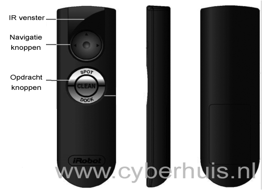

IR Remote Control for Roomba With Home Command?
Is this really a IR remote, if so then we can control the roomba fully by means of IR
But I have the feeling that it's nor IR
Anybody more info on this, because when its really IR a lot Domoticans will be really glad :)
Thanks to Erik for pointing this out
irobotstore.nl/index.php?main_page=prod ... cts_id=199
Roomba IR remote

0000 006C 0000 0008 006D 0027 0024 0071 0024 0071 0024 0071 0024 0071 006D 0027 0024 0071 006D 02C9
i bought the remote, this is what it comes back with in pronto edit pro 2..
the remote actually works, it goes back to the dock. (had to order a battery, though why not get the remote too and make some people happy) :-)
