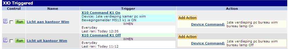

I overviewed you condition.
Now I placed that condition in the event, but still my light is going on at day.
When I move the motion controller by the window, he gives still an reaction to put on the light.
See below the changed event.

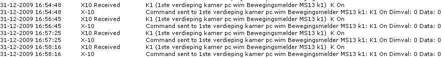

And the log file.

The additional condition should not be based on the motion sensor, this is the sensor triggering the event in the first place, but on the status of the dusk/dawn sensor (which would be k2, when k2 is your motion sensor). Did you have a good night of sleep?

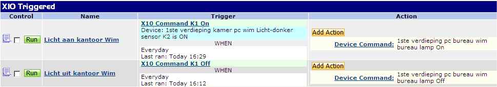

Hello Renee,
I didn't remember the extra sensor at the motion control. So I misunderstood you several times.
I installed now that sensor on K2. I corrected also the night/day setting back to 3.
Thanks a lot for your persistence and time you give to mine problem.
Nice night to night and a good 2010.
Below in my eyes your solution from my problem.
B.R. Wim :) :wink:
