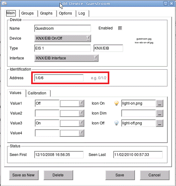

Re: Domotiga and KNX/EIB configure problem
I am not sure how we can simulate this without KNX HW @ your end..
I will try to explain this in more detail...
I am using EIBD to interface with the KNX bus.
(Berker GmbH & Co. KG:KNX-USB Data Interface)
http://www.auto.tuwien.ac.at/~mkoegler/index.php/eibd
I start it up with: eibd -d -D -S -T -i usb:1:4:1:0
then I monitor the bus with: Vbusmonitor1 ip:localhost
Now I start DomotiGa > Main > Devices
and add a new device (domoticaforum.eu/download/file.php?mode ... amp;id=776)
Device: KNX/EIB On/Off
Type: EIS 1
Interface KNX/EIB Interface
Address: 1/0/6
Value1: Off
Value2: On
Save
DomotiGa > Main > Control > (Click on) Guestroom [On/Off]
And in the Vbusmonitor:
LPDU: BC 00 00 10 06 F1 00 81 25 :L_Data low from 0.0.0 to 2/0/6 hops: 07 T_DATA_XXX_REQ A_GroupValue_Write (small) 01
LPDU: BC 00 00 10 06 F1 00 80 24 :L_Data low from 0.0.0 to 2/0/6 hops: 07 T_DATA_XXX_REQ A_GroupValue_Write (small) 00
See how DomotiGa changes the KNX address and is incorrect in the bus output:
1/0/6 becomes 2/0/6
If the address is:
2/0/6 it changes to 4/0/6
3/0/6 it changes to 6/0/6
4/0/6 it changes to 8/0/6
and etc....
(If I use groupswrite ip:localhost 1/0/6 1 or groupswrite ip:localhost 1/0/6 0
I can turn the light on and off so I know it works
Hope this helps....
Enable debugging on the EIB interface, and see what interface it says there
wwolkers,
I am not sure what you mean or how I can do this...
I am using a Pc running a Linux (Debian) + EIDB software (http://www.auto.tuwien.ac.at/~mkoegler/index.php/eibd)
connected by USB to the Berker KNX interface.
With the vbusmonitor command I monitor what is going on in the KNX bus.
I see that the DomotiGa app changes the value if it is not 0/XX/XX
In my setup it is 1/0/6 in DomotiGa but when the app sends the command to the KNX bus it is 0/0/6
And as the command from DomotiGa is now 2/0/6 not the correct value: 1/0/6 nothing happens.
Ace was so kind of letting me connect with my DomotiGa over the internet to the KNX bus of his house.
And after some debugging I suceeded to get it work.
I stopped when he got frightnened when I switched his light on and off
Knowing he lives in Iceland made it even more fun.
Thanks again...
Hi guys,
just wanted to let you know that with a lot of hard work Ron managed to get KNX to work with DomotiGa
The following devices have been tested and are known to work:
EIB1: Switches
EIB2: Dimmers
EIB3: Time
EIB4: Date
EIB5: Values (weather stations etc)
Ace
