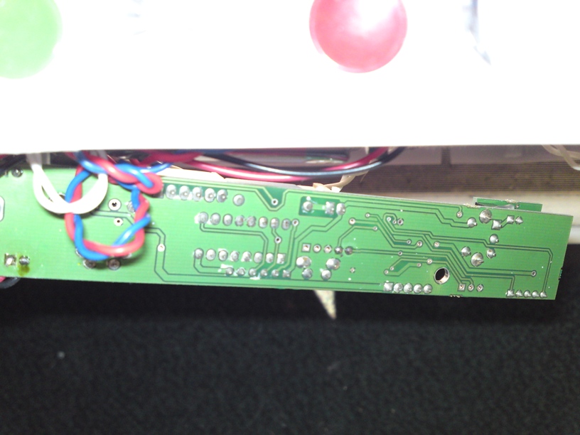

Here you can see the back of the print. With this I'll try to discover the pinout of J3, in order to make the connection to the board.

The connections of JP3, JP4 and JP5:
JP3:
Pin 1: Vcc2
Pin 2: GND
Pin 3: Connected to L293DNE (DC Motor controller) pin 9: (3,4EN function) enables Motor 2
Pin 4: Connected to L293DNE (DC Motor controller) pin 15: (Motor 2 RUN if Logical High)
Pin 5: Connected to PIC pin 6 (RA4)
Pin 6: Connected to right RFID-coil connection and also connected to pin 21 (RB0) of the PIC
JP4: (only solder points present, no pins)
Pin 1: pin 28 PIC (RB7) and ?
Pin 2: pin 27 PIC (RB6)
Pin 3: GND
Pin 4: pin 1 PIC (MCLR)
Pin 5: pin 1 PIC (MCLR) and pin 2 JP8
JP5:
Pin 1: +5 volt
Pin 2: GND
Pin 3: pin 18 PIC (RC7/RX/DT)
Pin 4: pin 17 PIC (RC6/TX/CK)
Pin 5: pin 16 PIC (RC5/SDO) Serial Data Out
So my guess is that with only JP5 and a RS232 cable it is enough to read the data, only the extra circuit for the RS232 connection I'm still figuring out, as most connectors use other pins of the PIC than the ones connected to JP5.
For example here is another connection, using the MCLR-pin of the PIC:
http://www.circuitsonline.net/schakelin ... eding.html
or
http://members.aon.at/electronics/pic/p ... PROGRAMMER
JP4 which only has solder points without pins, seems to be for programming the PIC because it is connected to RB6 and RB7 of the PIC. We won't need this I guess because we don't want to reprogram the PIC.

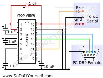

With the max232 chip it is probably the easiest method to connect the catflap to the rs232 port.
From JP5, these pins can be connected via the max232 to the rs232 port:
Pin 1: +5V
Pin 2: GND
See:
http://hades.mech.northwestern.edu/index.php/PIC_RS232
and picture.
And then we can read out the chip with either matlab or a Serial Port Monitor.

Yesterday I built the schematic above.
I connected a serial cable and the smartflap to that circuit as described.
Then I started a serial port monitor to see if there is some information on the TX output of the PIC when you press for instance the red button of the flap.
Nothing to see however. I have to wait for my Cat to come back from it's trip outside to see if there is something on the TX output when he gets scanned by the rfid reader, otherwise I have to think of something else.

Re: RFID Cat Flap computer connection
Keep in mind that TX = Transmit should be a 5 V signal on the side that is sending only the other end should NOT show any voltage, so check without the 2 connected that you have the tx from the one connected to the RX from the other and vise versa.
Regards, Maarten.
Thanks for your reply.
I measured the following voltages:
Rx of PIC (Grey disconnected): 0,93 V measured at PIC-side
Tx of PIC (Orange disconnected): +5 V measured at PIC-side
Rx of RS232 (Green disconnected): -5,85 V measured at RS232-side
Tx of RS232 (Blue disconnected): 0 V measured at RS232-side
I have the connection to the PIC as follows:
Pin 18 of the PIC is connected to pin 12 of the max232
Pin 17 of the PIC is connected to pin 11 of the max232
The rest is connected as the figure above describes.
I also did a loop back test. Herefore I connected Rx and Tx at the PIC-side. Then I sent some characters from the PC. They al echoed as expected, so the circuit seems to be fine.
Maybe the PIC is programmed to only respond to a certain input code, but I don't know which code.
once youre sure the TX and RX between PIC and MAX232 are ok just try to sned data to it and try to find anything that works, the correct speed and parity setting should give you at least some response.
Regards, Maarten.
The right speed and parity and other settings are unknown for me.
I tried 9600 and 19200 baud with 8 bits data, 1 stopbit and parity:none.
Might be these are incorrect. I'll try some more settings, thanks.
