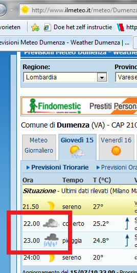

And Lorenzo you'll need a site that tells you when there is rain. The website you gave us report @ 23:00 rain, but i guess its not an accurate one. If it is accurate, please tell me. If you find another website (in text), i can help.

drmacchi wrote:Many time times (5 days in a week , it's accurated with time precision too !... , in winter the best performance). it's hard to find a text website .
i'll check .
Lorenzo. This website would do fine, but i can't believe the time would be accurate. Please see attached screendump. You tell me that @ exactly 23:00 there will be rain?

Not every time , it would be too much :wink: . But this winter, with the snow i saw many , really many times , winter falling down at their time , and rain too. So during winter performance is better

Okay, but would you use it if the predictions aren't accurate. The website we are using in this script does this (5 minute interval).
And ofcourse i would need examples.
