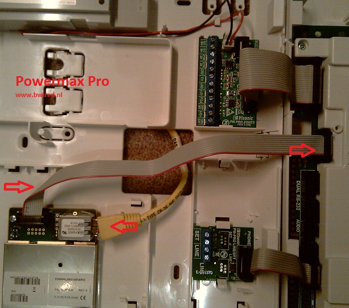

After I had build in the Powerlink2 I was wondering to which connector on the panel I had to put the flat cable. Found the answer in a previous post from Pieter. However, on my version of the panel I can put the cable in two different ways on this connector. Tried both, to no avail. The Ethernet link will not be activated (my switch says 'port down'). Then I discovered an option in the Powermax Pro module to learn in the Powerlink. Did that and I think this was successful because I heard a long beep just as when you learn in sensors. But, still no Ethernet connection. Yesterday I have been busy mailing back and forth with eBay Bob from the shop I bought the module from but he did not have a glue also. Monday he will contact Visonic. I will keep you all posted.
Did some of you which also have the Powermax Pro and the Powerlink2 experience any problems?

I think it can have something to do with the Firmware of the Powermax Pro.
I have a brand new Powermax Pro ans the Powerlink2 worked instantly on IP xxx.xxx.xxx.200
I did even not need to set the Learn Option in the menu of the powermax.
See below the Powerlink2 inside the Visonic Powermax Pro connected by a ribboncable.
Powerlink2

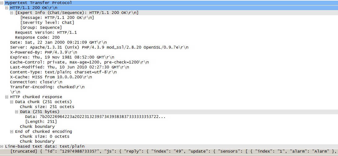

Re: Visonic Powerlink2
username/password in the url only works with very basic authentication, maybe they use another authentication method.
You can check the http headers with Wireshark to see if that's the case.
How did you conclude they use Java? The page is served by apache and php, at least that is what the http header mentions.
javascript.
Ah, OK. That is not Java.
