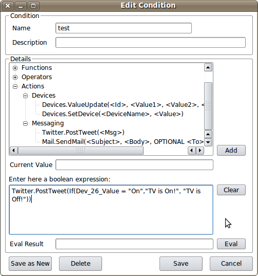

I don't even have the device values in memory right now.
I guess I start doing that when Gambas3 becomes stable, it support structures, arrays of different types, so I can mimic the device sql record in memory easily.
I have tested with a few actions inside the eval field, and that works ok.
Will try if I can get all current actions working from inside the eval field.
I think I leave all like it is, (keep multitriggers) but just add an action type 'Eval Script' or something like that in which you can do your scripting if needed.
Screenshot-Edit Condition.png (36.27 KiB) Viewed 11222 times
Edit: Actually it's not needed to add an action type, or change anything big, you can put the above in a condition already and don't create an action for that event.
Only need to check the action subs for private/public and that they return booleans, and define them in the treeview for easy adding.
Regards, Ron.
