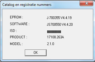

These are my version numbers en identification codes from both the panel hardware and software

Is the versions taken from the Remote Programmer software?
Yossi.
The version info I posted was reported by the remote programmer software.
