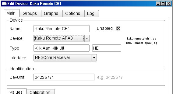

Not sure what KAKU remote you've got, I've got a APA3 unit. When pressing the switches you will see the following in the debug log:
2011/03/16 11:36:57 2210899DD090 HE Device=0422677 Unit=1 ON bits=34
2011/03/16 11:37:03 2210899DD180 HE Device=0422677 Unit=2 ON bits=34
2011/03/16 11:37:05 2210899DC1E0 HE Device=0422677 Unit=2 OFF bits=34
2011/03/16 11:37:06 2210899DC2E0 HE Device=0422677 Unit=3 OFF bits=34
2011/03/16 11:37:07 2210899DD2E0 HE Device=0422677 Unit=3 ON bits=34
Based upon that I've defined 3 switches (picture shows unit 1):
As you can see you will need to expand the HE Device number with the Unit number.
Right now I'm using a lamp icon, might be an idea to add 2 icons (switch on / switch off) to the image repository.
