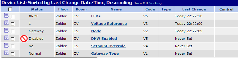

I did upload the latest version (02)of the script. See the opening post in this topic. I did not include the (basic) documentation yet, but added a screenshot of the devices and the events I have in Homeseer.

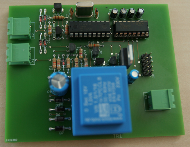

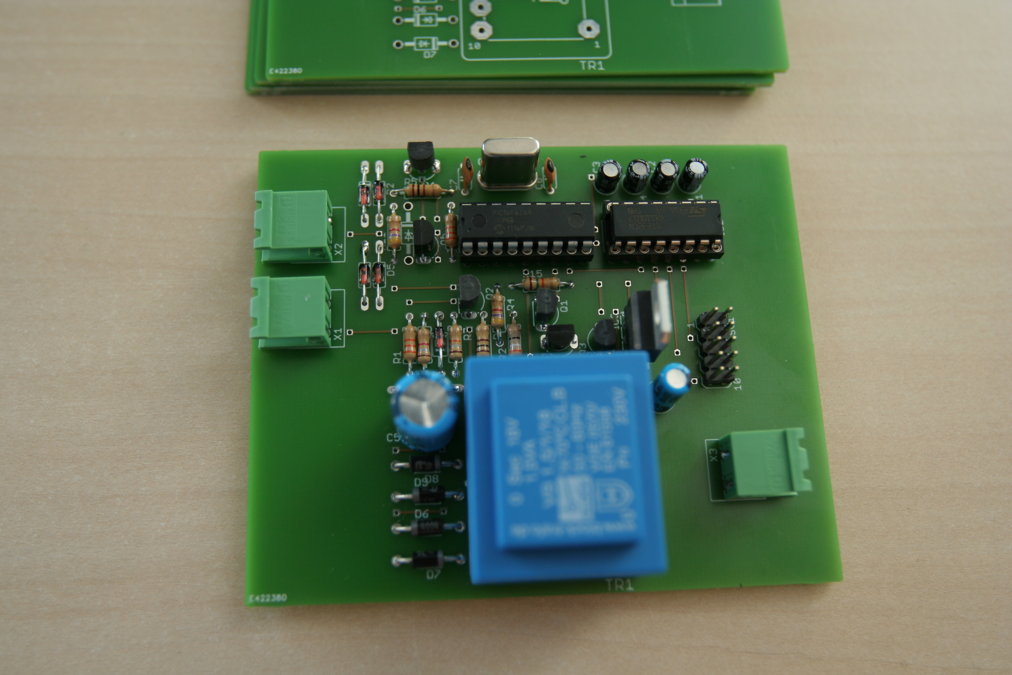

Still with great support of the developer and with the pcb factory of eurocicruits, i've managed to get a working gateway. :D

I think there will be quite a lot of members who'll be interested in how you managed eurocircuits to produce the pcb for you.
I have a half-finished perfboard version here, but actually I would prefer starting all over again with a pcb instead of finishing the perfboard version.
Did you create the necessary files for pcb production yourself, or..??

I've received the schematic and board (eagle) from the developer. Didn't realy change much on the board file. Only replaced some 90 degree corners to 45 and removed the fuse in the 230V circuit.
Also created a new 'silk layer' which should have been printed on the top side of the print but instead they've used the another layer from the eagle file to print, but it's only cosmtical. Part names aren't properly aligned, but after soldering all the parts and mounting it in a box, who notices :)

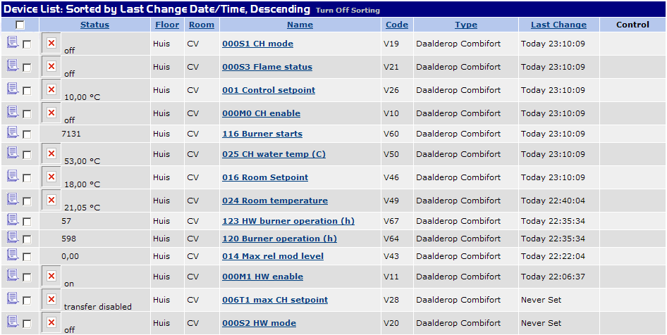

Wow Fabians, looks Great! Good to see you have it working and the script is running as well! Your intergas boiler does give more info than my Daalderop boiler, the number of starts and operation hours is not provided via Opentherm (although this info is available via menu on the boiler).
I don't understand your last question, maybe you can rephrase? In the last picture I don't see values, did you run the script "Run script: BLB_OT_monitor_02.vb("Main","PR=all")" already?

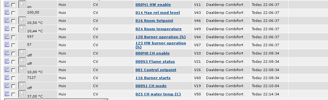

blb wrote:did you run the script "Run script: BLB_OT_monitor_02.vb("Main","PR=all")" already?
I did.. I've created the same two (time triggered & recurring) events.
BLB_OT_monitor_02.vb("Main","PS=1")
1st run
8-2-2012 23:09:36  - OTmonitor error - communication: Conversion from string "1T10010A00" to type 'Double' is not valid.
The second time it didn't return any errors.
Devices sorted by Last changes. All other devices are "never set".
blb

"1T10010A00" is an output after PS=0, which is default setting. Have a look at the output of the gateway when you connect to the serial port with e.g. Putty and give the command PS=0. After you provided one time PS=1 the gateway stops with sending all direct, real time output.
