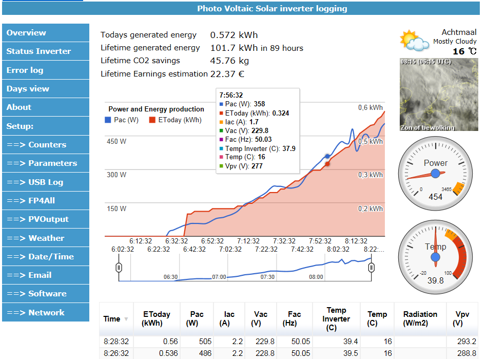

TANE wrote:What can the logger do more than plugwise?
Instead to sum up all items i will add two screen shots so you can see what's there. It's also possible to log to a few online (free) services and if you don't have a netwerk cable there then you can also log to an USB stick. There are also xml files available to download from the pvlogger. For HomeSeer i made a small vbscript to read a few values and put them into devices.

Niels wrote: Did you compare the energy production shown in the inverter with someting like plugwise or a pulse counter?
On tweakers i read frequently about differences from around 10% (where te inverter is too optimistic about the energy production).
I don't have plugwise. That won't be possible also because an installation of this size must have a fixed connection to the powernet. I didn't install a pulse counter for this inverter because i could use a seperate logger card to monitor things. This logging isn't done by the inverter but with the PVLogger card inserted into the inverter. It communicates via RS485 (if thas the right number) and collects it's own data. You can however compare the logging data with the data from the inverter. The inverter estimates the daily production in advance and is sometimes a bit optimistic. However this will middle out in the log run.
