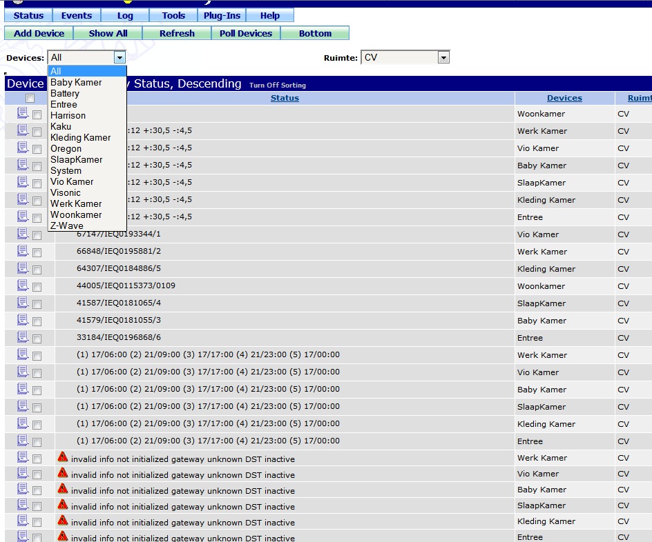

I got the same issue with that.. now i got rooms in devices and visa versa:
DST error is gone after some xx minutes from the start..

I have added the possibility to interchange location(1) and location2 via a new parameter in the ini file (DevLocationswitched) in the new version (02h). If this parameter is set to False (DevLocationswitched=False) the 2 location fields will be interchanged compared with the 02f version.
Bastiaan, I have also looked in your array error. I see there is still some information in the cube about other equipment than the thermostats (type 04) which is handled without error in the C response but causing this error in the L response. I think I can fix this with some better coding, currently I assume the length of the L response is always 12 bytes which is not true for e.g. a window switch.

Hi Bernard, Nice that you want to look at it again, thanks.
I have been testing a lot in between. Once I took out everything except two thermostats and then the first one got recognized but when creating the second one it went wrong with the same error message. The recurring script then also fails.
Then I took them all out and started clean, again, one got recognized and then everything stopped.
Looking at the debug strings, it is clear that even when I remove the Eco switch from the software, remove its battery, it somehow still shows up in the requests.

I have uploaded a new version, 02i, which should skip over L response from other elements than thermostats. I hope with this version your error is gone.
