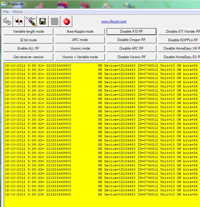

The latest AC door sensors have a wrong ON packet format and the ON (open) command is therefore not seen by the older receivers!
And here an example of a correct AC sensor producing 32 messages during 3 seconds.
