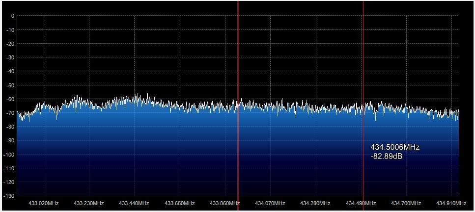

Fyi, i bought my Terratec Cinergy T Stick RC (Rev.3) stick at Dixons in the store for 25,- (NL)
Here's an example.
Used software is SDR# (SDRsharp)
What you see here is graphical overview of the frequency range from 433-435Mhz. This is a realtime screenshot. The red line in the middle is the frequency of the RFXcom transmitter.
The next images is a rainfall image. Vertical axe is the time axe with the newest information on the top and horizontal the same frequency range of 433-435Mhz. The displayed information is for about 25 seconds. At the bottom you see a transmission of RFXCom and the horizontal line in the middle is caused by a transitting motion detector. As you can see there aren't any other transmission in those 25 secs. When i let it run over a longer period of time this hardly increases.
I hope this help a bit.

Thanks for that - very enlightening - would be interesting to see and compare how it looks here.
