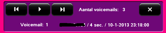

I use the following scripts
See the attached HSTouch screendump which are associated with scripts.
Play Voicemail
Sub Main(ByVal param As Object)
   Dim CurrentVoicemail As Integer
   Dim Number As Integer
Number = hs.DeviceString ("+25")
CurrentVoicemail = hs.DeviceString ("+41") -1
If (Number > 0)  Then
         hs.Plugin("Fritz! Box").PlayVoiceMail(CurrentVoicemail, False)
End if
End Sub
Delete voicemail
   Dim VoiceMailInfo As String
   Dim VoiceMailDate As String
   VoiceMailInfo = hs.DeviceString ("+26")
   VoiceMailDate = hs.DeviceLastChange ("+26")
' hs.writelog("Fritzbox", CurrentVoicemail)
         hs.Plugin("Fritz! Box").DeleteVoiceMail(CurrentVoicemail)
End if
    hs.SetDeviceString ("+41","1")
    hs.SetDeviceString ("+42",VoiceMailInfo & " / " & VoiceMailDate)
    hs.SetDeviceLastChange ("+41", now)
    hs.SetDeviceLastChange ("+42", now)
 Else
     hs.SetDeviceString ("+41","0")
     hs.SetDeviceString ("+42","Geen VoiceMails")
End if
End Sub
Forward
' hs.writelog("FritzBox", Number)
' hs.writelog("FritzBox", CurrentVoicemail)
If (Number > 0) and (CurrentVoicemail <> Number) Then
         CurrentVoicemail = CurrentVoicemail + 1
         hs.SetDeviceString ("+41", CurrentVoicemail)
End if
End Sub
