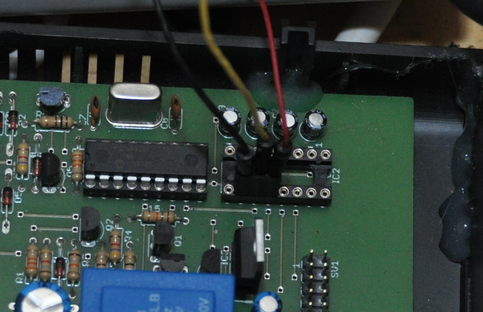

I had some questions about how exact to connect the EZL on TTL level to the OTG (OTG without the MAX232)
Configure the jumpers on the EZL-70 for TTL
Black = GND on EZL
Yellow = TX connect this to RX on TTL connecter the EZL
Red = RX connect this to TX on TTL connector the EZL

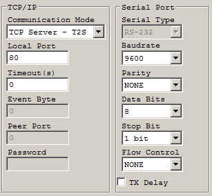

Run the ezConfig tool for the EZL-70
Click on search all and the tool will show you the EZL's on your network.
make the following settings
for pin settings and EZL configuration see here http://www.domoticaforum.eu/viewtopic.p ... =15#p60164
