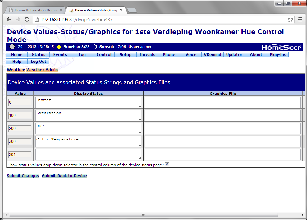

'HueControl.vb
'by B. Bakels
'19 Jan 2013 - version 2.0
'USAGE with HomeSeer
'Make an event and select script.
'For the parameter field use ("Main","control;B80;B90;1")
'where: ("Main","<executionmode (control or status)>;<DeviceCode Homeseer Control Device>;<DeviceCode mode Device>;<Hue Number to control> ")
'Main with a capital M
'there are 2 execution modes; COntrol: controls the Hue lamp
' Status: Updates the homeseer device status with the current hue status

Dim strExecution As String = hs.StringItem(Params, 1, ";")
Dim strDeviceControl As String = hs.StringItem(Params, 2, ";")
Dim strDeviceMode As String = hs.StringItem(Params, 3, ";")
Dim BULBNO As string = hs.StringItem(Params, 4, ";")
'Calculate Values and get devicestatus and value
MODE = hs.DeviceValue(strDeviceMode)
ACTION = hs.DeviceStatus(strDeviceControl)
BRI = hs.DeviceValue(strDeviceControl)*2.54
SAT = hs.DeviceValue(strDeviceControl)*2.54
HUE = hs.DeviceValue(strDeviceControl)*655.35
COLTEMP = (hs.DeviceValue(strDeviceControl)*3.46)+154

Het zou zo mooi kunnen zijn, maar ik krijg het script zonder php niet aan de praat. Alle waarden in de debug mode zijn gevuld en krijg de volgende resultaat:
Doe ik wat fout of heb ik misschien een "verlopen" .net versie?
MVG
Arjo.
19-1-2013 22:51:38 response [{"error":{"type":5,"address":"ð","description":"invalid/missing parameters in body"}}]
19-1-2013 22:51:38 send {"on":true,"hue":52428}

Bart,
Hier een stukje log, dit moet van onder naar boven gelezen worden
Hopelijk zegt het je wat
19-1-2013 23:33:34 send {"on":true,"hue":39321}
19-1-2013 23:33:34 huecontrol Debug calculated color temperature :362
19-1-2013 23:33:34 huecontrol Debug calculated Hue :39321
19-1-2013 23:33:34 huecontrol Debug calculated Saturation :152
19-1-2013 23:33:34 Huecontrol Debug calculated Brightness :152
19-1-2013 23:33:34 Huecontrol Debug Selected Mode :200
19-1-2013 23:33:34 Huecontrol Debug Execution mode :Control
19-1-2013 23:33:34 Huecontrol Debug Action :4
19-1-2013 23:33:34 Huecontrol Debug Hue Number :1
19-1-2013 23:33:34 Huecontrol Debug Device for Mode :A21
19-1-2013 23:33:34 Huecontrol Debug Device to Control :A20
19-1-2013 23:33:34 Event Running script in background: HueControl.vb("Main","Control;A20;A21;1")
19-1-2013 23:33:34 Event Event Trigger "Hue1"

Rebel,
Hierbij het script als vb file (als zip) tevens 2 screenshots van mijn configuratie. Het werkt hier gewoon zonder issues. ZIjn er andere mensen die het ook getest hebben? Ik ga vandaag waarschijnlijk nog even verder met de status terugmelding en een flashing functie.
Hopelijk werkt het nu wel voor je...
MVG
Bart
MVG
Bart

- Mode device config.png (77.45 KiB) Viewed 11174 times
- event config.png (9.01 KiB) Viewed 11174 times
