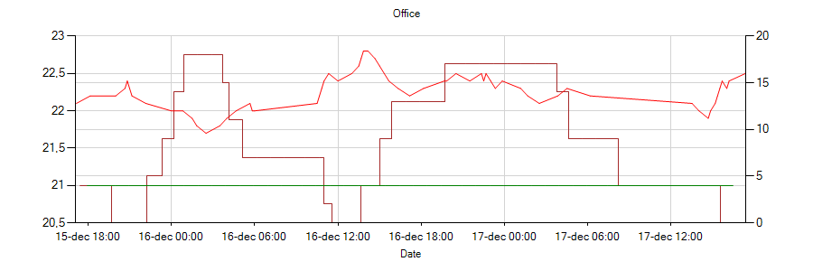

Here you can see the behavior of a ELV MAX Radiator valve trying to keep the temperature constant.
Bright red = Temperature (Oregon Scientific), Dark red = valve position, green = temperature setpoint.
Still need to do some calibration :wink:

Digit wrote:Here you can see the behavior of a ELV MAX Radiator valve trying to keep the temperature constant.
Are you using a PID controller? Something like https://npmjs.org/package/node-pid-controller

@Robert
Nice graph :) Indeed some calibration has to be done :D Have you measured the temperature which the max! thermostat reports also? In my test room, the max! thermostat reported half a degree to high. So I adjusted that in the max! software and now the thermostat seems to control the temperature reasonably well, within +- 0,5 degrees celcius.

sj3fk3 wrote:Are you using a PID controller? Something like https://npmjs.org/package/node-pid-controller
The max! thermostats, like any thermostat out there I would think, have of course there own PID controller embedded. And I should think that two PID controllers won't operate well together....
Re: Is ELV Max! a reliable system compared to FHT80b (or ZWAVE)
No no, the Cube & Radiator valve do that - I just tell the ELV Max system what temperature I want, that's all.
Aah, ok.. I thought for a second that you wanted to override it all.

pbrand wrote: Nice graph :) Indeed some calibration has to be done :D Have you measured the temperature which the max! thermostat reports also? In my test room, the max! thermostat reported half a degree to high. So I adjusted that in the max! software and now the thermostat seems to control the temperature reasonably well, within +- 0,5 degrees celcius.
No, cause I don't have the Max! thermostats. I already had a lot of temperature sensors in the house, so no need for them.
