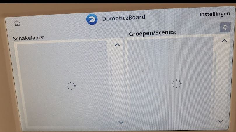

Hypermobile
Posts: 76
Re: Toon app: DomoticzBoard
Post by Hypermobile »
After no changes on my side.
The buttong won't show up anymore.
- Lan+Internet are working.
Also an minor issue,
Trying to fix it;
i filled in the UserName & Password. no luck
but removing the User+Pass is impossible, after saving, it's there again.

Hypermobile
Posts: 76
PeJeWe wrote:
Xavier wrote:Hi all,
Does any one of you use Users in Domoticz?
I have created a user in Domoticz.
I have entered the credentials in the DomoticzBoard app (username and password) but I still see all switches instead of the switches I have connected/added to this specific user.
Seems like username and password in the DomoticzBoard app don't work.
when you put the IP of the toon in domoticz in the field "lokale netwerken" in settings/Instellingen, then you dont have to use users/passwords.
or you can add a IP range example: 192.168.1.*
the star stands for 1 up to 254 range
Due to that bug, you cannot remove the user + pass....after saving, everything is back to the old Pass/User.
i have 192.168.0.12 as a IP and Port 8084 (Domoticz on a Synoly Nas).
it worked for a Year straight....now it doesn't work ..anymoren on Toon
Hypermobile
Posts: 76
i gave my modem a Reset, now it's fixed... :D
