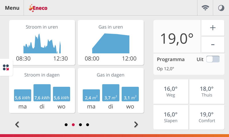

So with a bit of messing around, based on a lot of information found in this topic, I managed to:
  • add a second bar graph to the current power tile, that shows the amount of Watts I'm returning to the electricity company
  • display some basic weather information
  • add the day of the week and seconds to the clock tile when it's not dimmed.
The necessary data is obtained in JSON format from my domotica system.
Thanks to all who contributed to this topic. I couldn't have done it without your valuable input. Keep up the good job.
