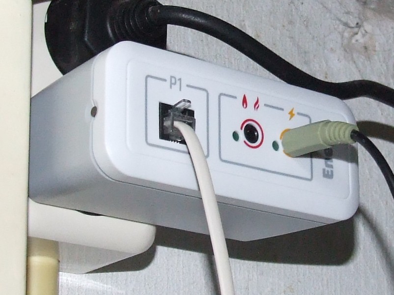

Are there people out there with toon zon?
I'm trying to figure out why my set-up doesn't work.
Could you please post your meter adapter product number (6500-xxxx-xxxx) and firmware version?
If possible could you also post a picture of the sensor on the kWh meter?
TIA,

Regarding the double icon meteradapter, can you post a picture?
Yes, see attached picture. The serial number is 15-xx-yyy-zzz (don't know the exact number, don't see the need to unplug it now).
More important is the firmware version, I think (0.15/0.11). The adapters with this FW have newer processors with larger flash, and a newer zwave interface (500 series instead of the ZW0301 on the older adapters, IIRC).
Don't really see what the problem with the older ones was, data flow is not a lot higher with the extra connector, and the number of bytes in a DSMR packet is only a few hundred bytes every 10 seconds, not something requiring a lot of bandwidth.
Anyway, this works.
grtz,
