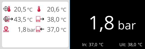

Posts: 1918
Re: Toon apps: feature requests
Getting there slowly........
I removed the tapwater readings as these are not stored on Toon.
For the same reason also had to remove the outside temperature and the boiler modulation level.
Screenshot below with the normal tile and the same tile in dim state:
Comments?
Kind regardz,
gielie
Posts: 70
Post by gielie »
That looks really nice, can you tell me what kind of ketel u have?
I can imagine that the info differs from the brand and type of cv is used.
I just bought a new one a Rameha tsera.
